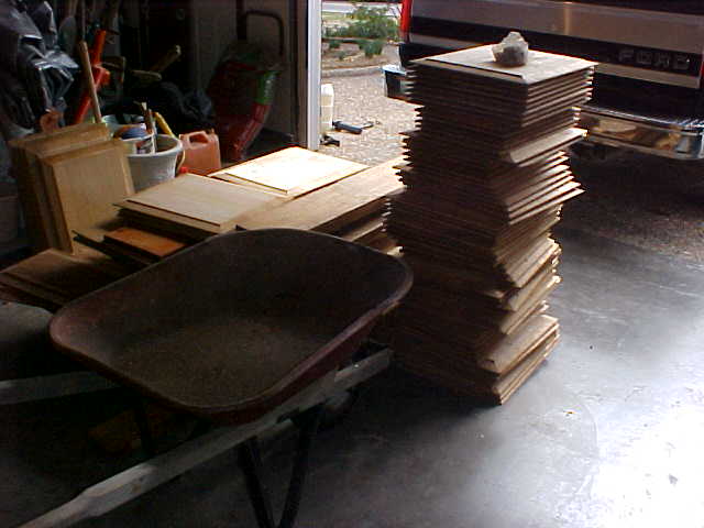

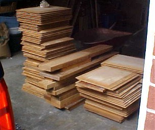

An old garage door company hung it up about thirty years ago. My buddy hoarded up much of the old reject panels of solid quartered wood. I believe it's fir. A luthier/carpenter friend stopped by today, he thought cedar. Other boards the styles, which are larger are definitely not cedar. There are a few panels of redwood. So, I'm wondering, what it is that I have, any guesses? Here are a few pics.

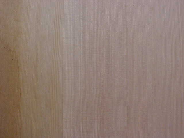

Based solely on the second picture I would say it's Sitka. Look at the pinks and mauves in it. DF is pretty consistent in color (tanish) and has wavier grain with micro short streaks of darker brown whereas Sitka varies widely in colors. If it is in the pine family it will gum up your drum sander where Spruces don't have the pitch problem. Cedar will smell where Sitka won't have an odor. My stash of 59 Sitka is brownish in color like the first picture.

Hmmmmm, I dunno. All I know is it's dry straight, most of it, low on the smell. One reason I don't think it is Sitka Tim, is the lack of medullary rays. Good quartered sitka would show silking and rays. This stuff is really well quartered, amazing they cared about it on glueup for a door panel.

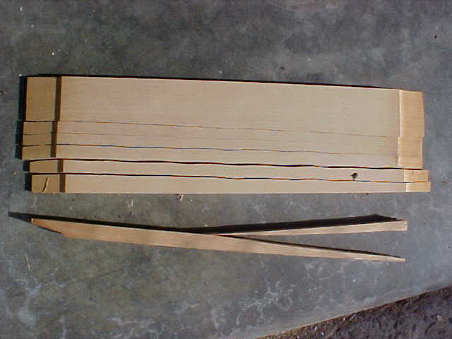

Split some on the thin side? Okay, Runout meaning going from the back of the panel to the front. I think I get it. Pics to follow.

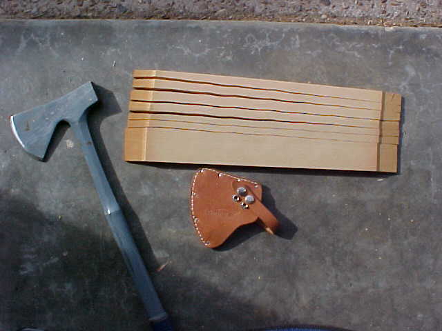

While not representative of the whole stack, this one piece reveals what Mario is getting at I guess. There is a little wave going on with this piece, but runout pretty much queers using this sample.
Okay, looks like I have a lot of nice dry easy to split kindling.

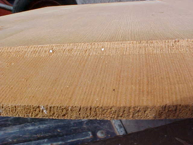

Okay, here is another sample, and i believe Tim and Mario are right this is Sitka. The sanded surface did not reveal the medullary rays like the split surface did. Also this sample had little runout and is probably acceptable. Maybe a slice has to be sacrificed to find out if it's acceptable.

That's a lot of runout, Bruce. It runs off about 1/4" over what, 10"-12" in length?

I think I'm gonna just do some tests with some of it destructively and see how much it can handle compared to my Sitka bracestock suppliers stuff.
This aged material may really induce some tone, if I can get some that meets the criteria. Even the first piece with 1/2 inch of runout in eight inches, might be actually very strong. The second test was an eighteen inch piece and had a 1/4 inch in eighteen, pretty good I thought?
This stuff sure needs to be cut and stored, right now it's taking up my wife's car space. I lost my side of the garage two years or so ago.
